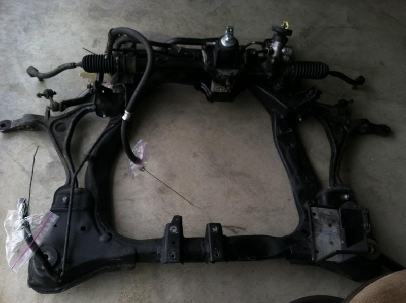

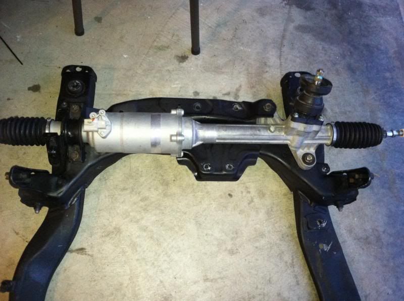

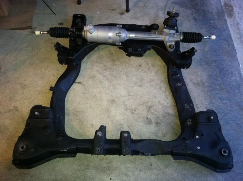

Finally had a chance to get the sub frame out yesterday.  I double checked the clearance with the EPS motor and everything looks good.  I need to bring the sub frame to my welder to have something taken care of.
« Reply #471 on: May 01, 2013, 10:43:43 AM »

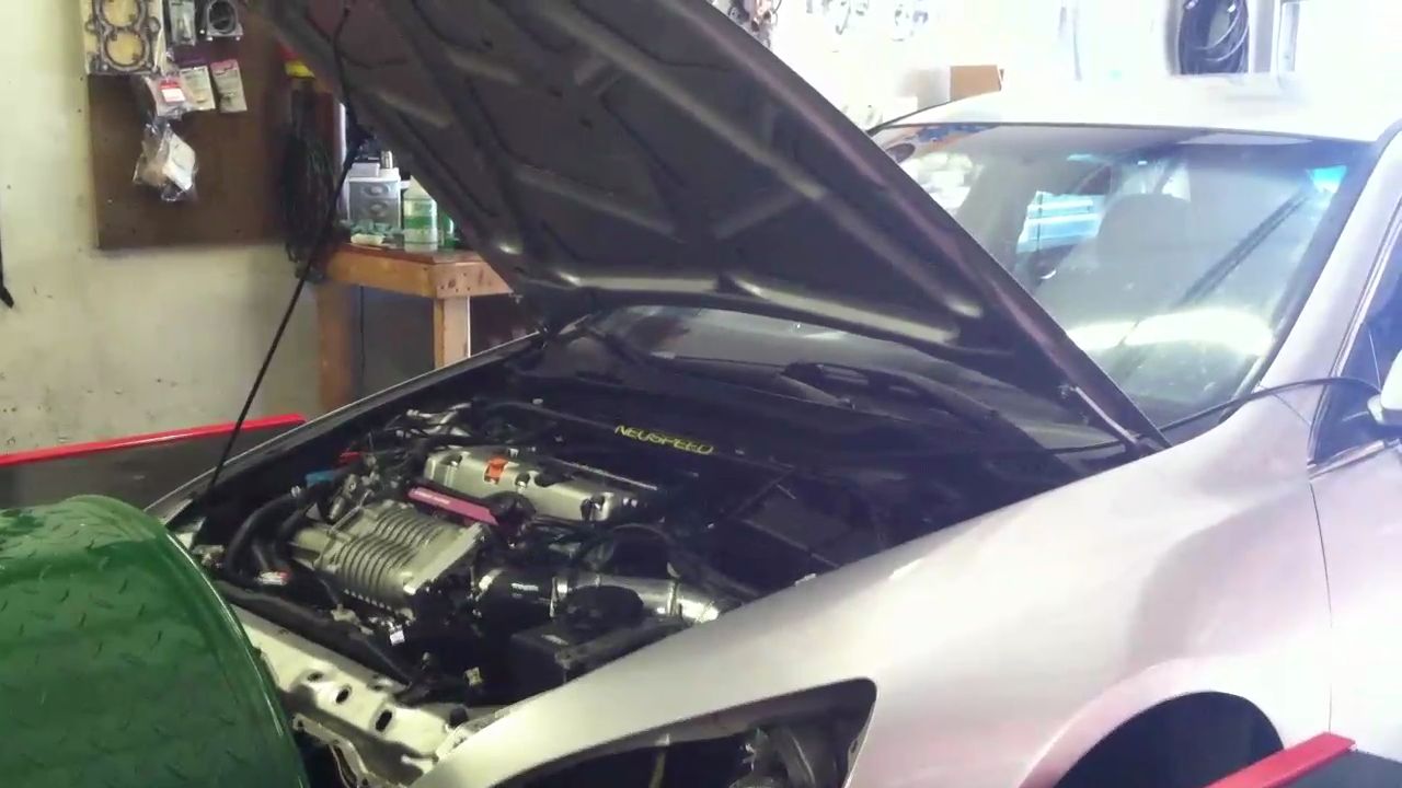

EPS is in and working.  I had a chance to test everything out last night and it's working pretty good.  The TVS adapter is being machined right now.  Once we get everything on and lined up, the fabrication of the aftercooler will start.  I'm hoping to stuff a 3" Bell water to air core in my manifold to get temps as low as possible.

With a 3" pulley at 8400 rpm, the TVS was making 16.8 psi.  The injectors are limiting my power right now.  I'm going to step up to some 1300-1600 cc injectors and go from a 3.0" to a 2.5" pulley.  That should help me reach my power goals.  Right now, my car pulls pretty good where it's at.  I'm still trying to make more power though.
