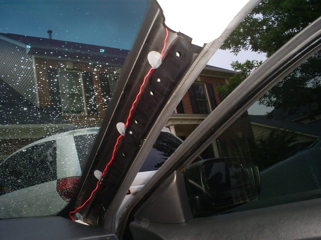

2. run a wire from the overhead console down the passenger side A pillar to the glove box
down the A pillar:
to the glovebox:
its the red wire!
