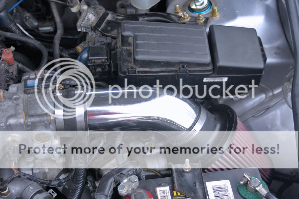

I recently got an intake made for my car over at Jotech Motorsports in Dallas. If I had known that there was already an option out there I would have been better off buying Paul's if I remember correctly. I had the breather hose coming off of the valve cover removed so there is less lines running around and plugged it with a 1/2" K&N Filter. It does have a nicer sound to it than stock. I am pretty pleased with it though.

Looks good man. I may be wrong, since I don't know as much about J Series motors compared to others, but I'm pretty sure you should have the vacuum line from your valve cover to your intake. I understand the philosophy behind cleaning up the engine bay, but I believe it's better to have a vacuum in the valve covers to evacuate blow by gasses more effectively. A good catch can would be a move in the right direction.

that doesn't look safe at all... and what's with all those wires ?
Re: My SRI
January 21, 2015, 01:12:55 PM »
Holy hell, clean up that engine bay man. That looks like a fire waiting to happen.
Re: My SRI
January 22, 2015, 12:52:53 AM »
wtf is that?

various Lighting Wires, everything is on a Fuse and most are ran straight from the Battery rather than off the Fuse Box and should pop fuse before any wire melting
haven't had any problems but agreed, will try to clean it up soon
